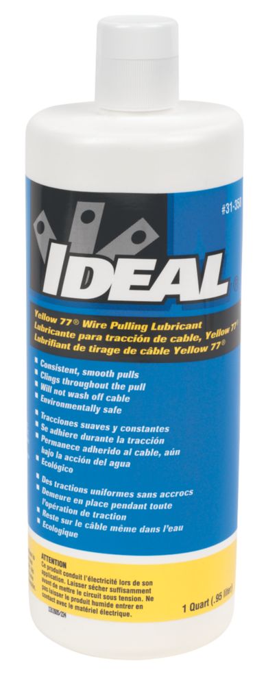

If you do try to pull a new cable through, then something like this might help:
Yes may try that or like Nealh said butter from fridge lol but god knows how I’m going to thread 8 wired or 9 cable through the axle as it seems it goes through side of axle and out through top but I can see a clip at bottom of axle so maybe that will remove that end of axle not sure yet also not sure if sensors need replacing I think they ok
