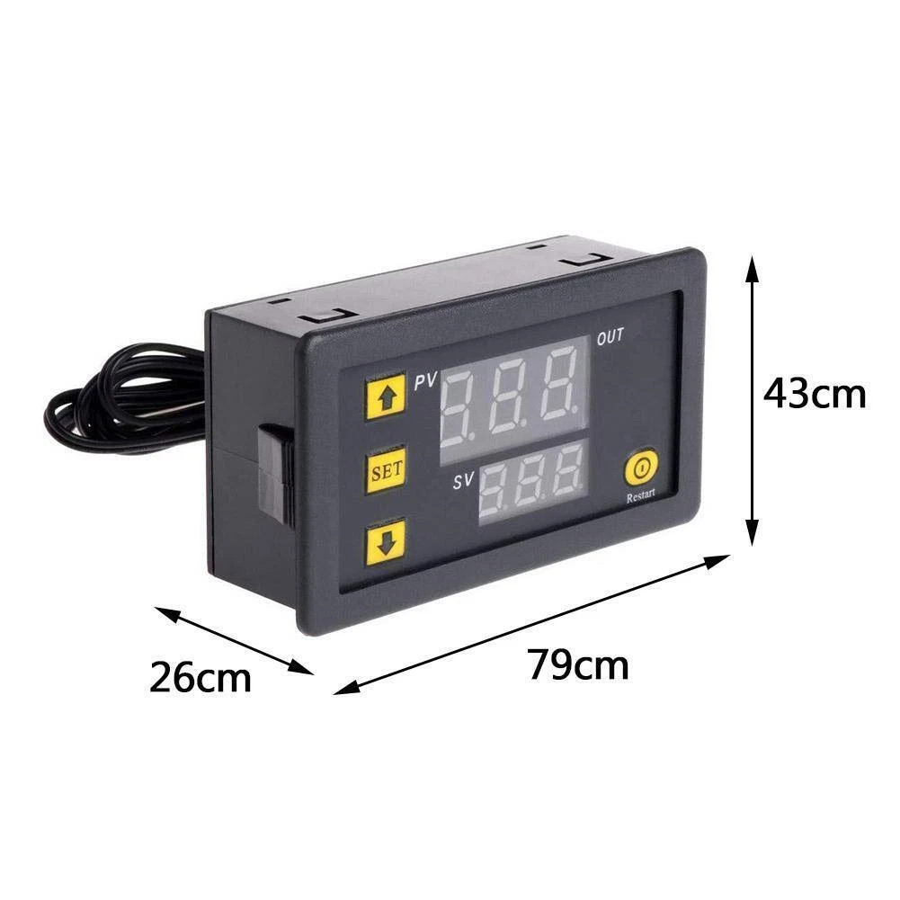

Whenever these arrive from China, I'll assemble the Public Transport Ruination by Ebike Battery Fire Expulserating PreTerminator™®©℠!
Sorry to say there may be a video. Sadly, there may also be audio.
(Hope it isn't 79cm wide: Size: approx. 79*43*26mm )
