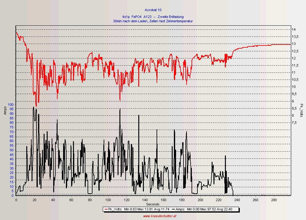

to show some real-world data,
here a graph i logged last weekend in my E-Heli...
think about: only 4 cells were used !!!
battery-weight: only 280g !
still peaks in the 900Watt Region !
Average were 250Watt (out of this 280g battery !)
after the flight the batts were around 40°C hot (they are allowed to reach 60°C-70°C by the manufactor)
and recharged with 8A-charger within 16min !
here the graphs:

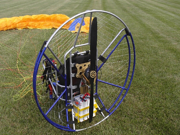

oh: just another example what is possible with NEW generation, high-power Lipos:
the pack on the pic can give up to 55.000Watt !!!! of power ! (the motor can not handle that much, and of course it would result in too short runtime.. but the batts can handle it !)

after 75cycles a test has shown, that the cells within the pack are drifting only by 0,004 Volt maximum !
thats less than 0,1% !!!
so there is absolut NO problem paralleling this cells !
(Bosch for example sells there power-tool-packs with paralleled cells inside !)
conclusion:
i think it will last 2-3 years until this good cells will become available for e-bikes too...
(i see it in the rc-market: we are flying already for 3-4years with Lipos... the Rc-boats have started 1-2 years ago, and rc-cars are starting this year.....
and on e-bikes market is MUCH slower)

Thank you again kraeuterbutter. That fits well with my understanding, and I agree that it will probably be two to three years before we get the newer types.
At present, I find NiMh are still often best in practice on electric bikes, simply because the Lithium types often drop voltage so much that the cut-out operates when under high current drain conditions. In that respect NiMh are superior at present since the voltage drop is so much less.
I would rather reach the top of a hill with a technically inferior battery than fail half way up with a technically better design! :)
Hopefully there may be much better things to look forward to in our bikes.
The video is very good in every way. Stunning flying control and excellent camera work, especially the skill of keeping the helicopter centre screen. If only our full size helicopters could have this incredible agility. Perhaps the passengers wouldn't survive though!
