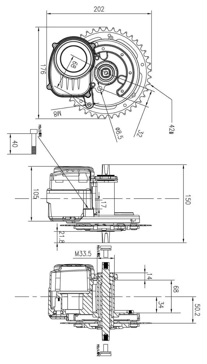

I just dropped the motor in like a customer would into my Giant Defy test bike, it still has the factory supplied single ring and the chainline is centred on gear No 5 of my 8-speed test road bike, pretty much the same with the previous Shimano crankset that I took out.
You may find the drawing useful:
https://ae01.alicdn.com/kf/HTB1OJSRPFXXXXcrXFXXq6xXFXXXt/221886021/HTB1OJSRPFXXXXcrXFXXq6xXFXXXt.jpg

The kit arrived and I had real difficulty removing the bottom bracket. I eventually gave up after contemplating my large lump hammer on the bench and took it to the local bike shop. They had to employ a boilermaker's 3ft spanner to shift it after heating/cooling the bracket, eventually they shifted it.
I decided it may be prudent to get them to fit the motor while it was there. The only other difficulty was the gap between the bottom bracket and the motor housing is about 3mm. This is a crucial measurement and is not highlighted anywhere on any site I have seen, least of all Whoosh! The technical drawings supplied do not even show this most important distance-it defies belief.
The guide for the rear gearset is attached to all standard bike's bottom bracket here and most are well over 5mm, mine was almost 15mm. There is no way the motor would slide into the bottom bracket housing with this guide. The bike mechanic tried 3 different guides, all had much too high a profile to allow the motor to slide into the bottom bracket. In the end, he said lose the guide altogether, let the bottom bracket decide where the cable goes and we will just hope for the best. Not a very satisfactory outcome, I'm a firm believer in the manufacturer knowing more than I, they do not fit extra parts for the sake of it.

I did give a warning in post #6 in the TSDZ2 thread about the cable guide under the bottom bracket:
some pictures of the 16.5kgs STDZ2 test bike.
One word of warning: if you have cable guide under the bottom bracket like on this Giant, it'll be a little fiddly to fit. Take the rear wheel off before fitting the motor.
To anyone contemplating the same kit, you will need to file down the cable guide and shorten it a little bit so it's just tall enough to hold the rear derailleur cable. It is not difficult but time consuming to do, as I did for my Giant. http://wooshbikes.co.uk/2018/tsdz2/giant.jpg
Also on the web page, it's a common issue for all bottom bracket motors:
Be aware of the physical issues around the bottom bracket:
Like the BBS01B, the TSDZ2 will fit bottom brackets whose shell is 68mm or 73mm long.
However, the space between the motor's bottom bracket and the motor's housing may not be enough to accomodate your cable guide.
If your bike has one mounted under the bottom bracket shell, please email us a picture for advice.
Also, if your bike has a side kickstand mounted close to or right behind the bottom bracket, please email us a picture for advice.
http://wooshbikes.co.uk/?cdkit#tsdz2
