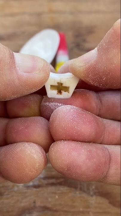

After first testing the plastic to see if it's melted by superglue - if the plastic doesn't melt I'd be inclined to try superglue + fine grain bicarbonate of soda. It sets as a hard plastic, and although I've repaired household objects with it, I haven't tried tapping a thread... but perhaps that's possible? It can be sanded, drilled etc. into shape. Superglue + graphite (sandpaper pencil lead) looks even stronger, I haven't needed to use that yet.
Have acetone handy, to dissolve it off your fingers. The combination is the strongest glue I've ever used. Sets very fast.

Local Bike Shop.
Oh fantastic, thank you!
