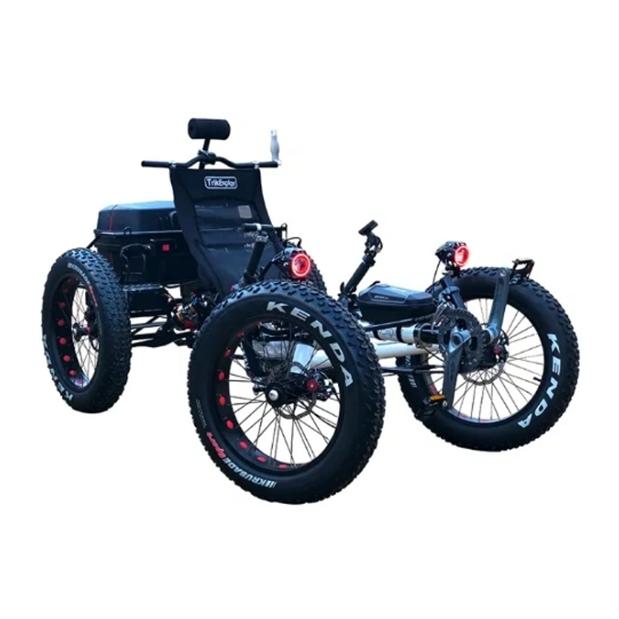

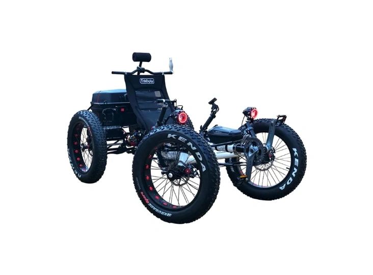

ICE have a couple of specialist tadpoles which would give better stability and easily take a mid drive. The Adventure and Adventure HD for normal use, and the Full Fat for going anywhere. Including electric versions. But budget can quickly get out of hand.

Someday, one of those will be mine! But only when there are lightweight fully enclosed versions available, with solar panel arrays on the roof.
