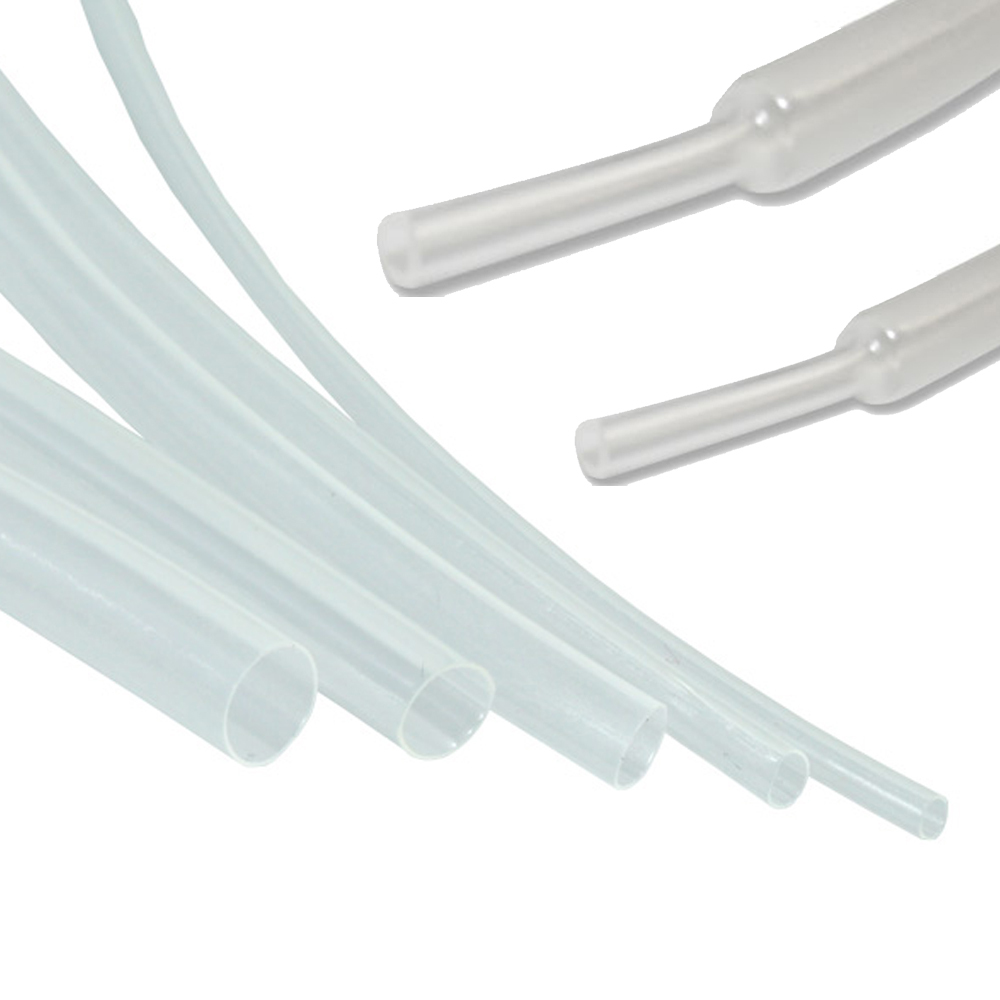

Please don't do that. Those bullet connectors will work loose and melt in the end.
All batteries I've ever had from BMS have Anderson Powerpole 30A connectors on. Available on EBay.
I would buy a slack hand full of them, and also replace the crappy bullets on the phase wires, as they normally melt too.

Thanks Mike & Trex for your advice. I'm going get some anderson connectors and some heat shrink tubes.
