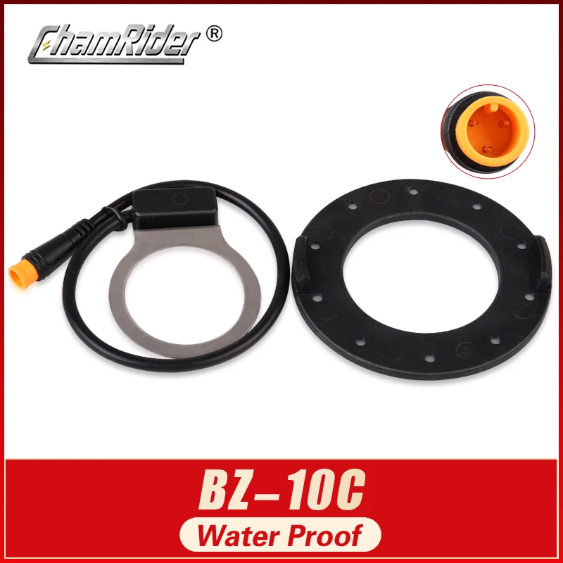

For minimal hassle, I’d order a spare pas too - I’m assuming this has the correct connector for your controller ?
US $12.26 5% Off | Waterproof connector BZ-10C PAS System Pedal Assistant Sensor 10 Magnets For Hollowtech Crank Crankset Ebike Conversion Kit Part

Re: that PAS I’ve been trying to avoid having to remove the crankset as I don’t have any special tools for it, though I am coming round to the idea of fitting a larger chainring as the bike is too fast for the existing gears.
