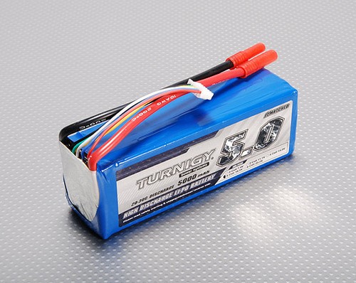

that pack you wanted to buy is a 4S, 4 cells in series, 16V.
You need 10 cells in series, 40V to run with your BBS01. You'll have to connect two 5S packs to make a 10S pack. Can your quadcopter use 5S?

yes, that's right, use a Y piece to connect the two 5S bricks. Don't worry about constant discharge rate - you'll get plenty.

Here is a solution: open the base of your bottle battery, attach a 2-core 14 AWG silicon cable about 10cm to the two battery terminals, then crimp a pair of 30A Anderson plug to the other end of the 10cm cable.
That's the Anderson tail, you can now plug in your new parallel lipo battery there.
You need also make an extension lead to go from where you want to install your lipo packs to that 10cm Anderson tail. That extension lead needs to be 2-core 14AWG also but must be round cable and sheathed. Fit a pair of 30A Anderson to the bottle battery side and a JST to the lipo pack side.
You also need to fit lipo alarm.
It would be a lot easier to just buy a 15AH 36V battery from Eclipse and sell your 9AH battery secondhand.

I was hard read your englsih what mean you said, i am deaf is hard full english so i am BSL is deaf and not english. if you post here easy english and show pics will help know?
I ordered all:
2 x ZIPPY Flightmax 5000mAh 4S1P 20C
1 x Y
3 x 4mm Gold Connector w/ Protector (male/female)
1 x 14AWG Silicone Wire 50cm Black & Red
trex
May 15, 2011
7,703
2,671
that's a good start.
Those gold connectors are not foolproof.
Anderson connectors are better, as you are going to plug/unplug to charge the lipo packs, you can't take the risk that the terminals can come into contact wrongly.
Let's wait until you get as far as you can go. Then come back and we'll help you some more.
That's the wrong pack.
You need 5S, not 4S.
You will kill your 9AH bottle battery if you connect it to the new packs.

Well done, I don't speak good english, deaf is mean speak British Sign Language.
I am lost ordered now, I think 5s = 5000mah so i am wrong now. mean "5S cell" I know now that. I think you told don't worry, any battery zippy or turnigy 5000mah so I buy pick battery. Need info sent me the battery or link i buy it now.
