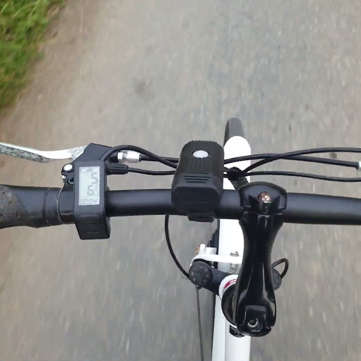

Hi everyone, just tried to upload a video but got an error during the process so here's a direct link to a video with the problem that I uploaded on YouTube so you can hear the motor when I select the 5th speed. Hopefully you can open it and get a better idea on what's going on. Thanks.
20,916
8,529
61
Yes is a phase issue.
What is your C5 setting, is too much current being asked for ?
20,916
8,529
61
It may just be that the motor doesn't like the Kt controller, personally I have used a few different hubs with sinewave Kt and never encountered an issue so can only assume it may be an incompatability issue.
