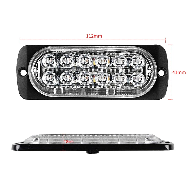

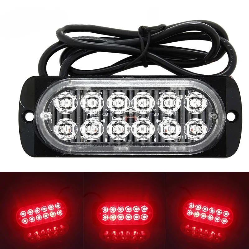

12,235
3,411
Although these may not be bright enough (they should be, drawing 0.333A), these are the narrowest, lightest and thinnest red LEDs I have found so far, to Araldite onto my mirror reflectors. Because I don't need the holes, I can make them less wide, by sawing off about 1cm of the ABS either side. If they're not bright enough for my mirrors plus handlebar stem (while riding, in addition to the white headlight pointing at my hi-viz top, illuminating me with red light), I could use them on the bike trailer instead - but I'll keep looking for brighter... because I'm not convinced they'd be high conspicuity enough in daylight.

These might have to do. Compact and light-weight. Very roughly to scale:
