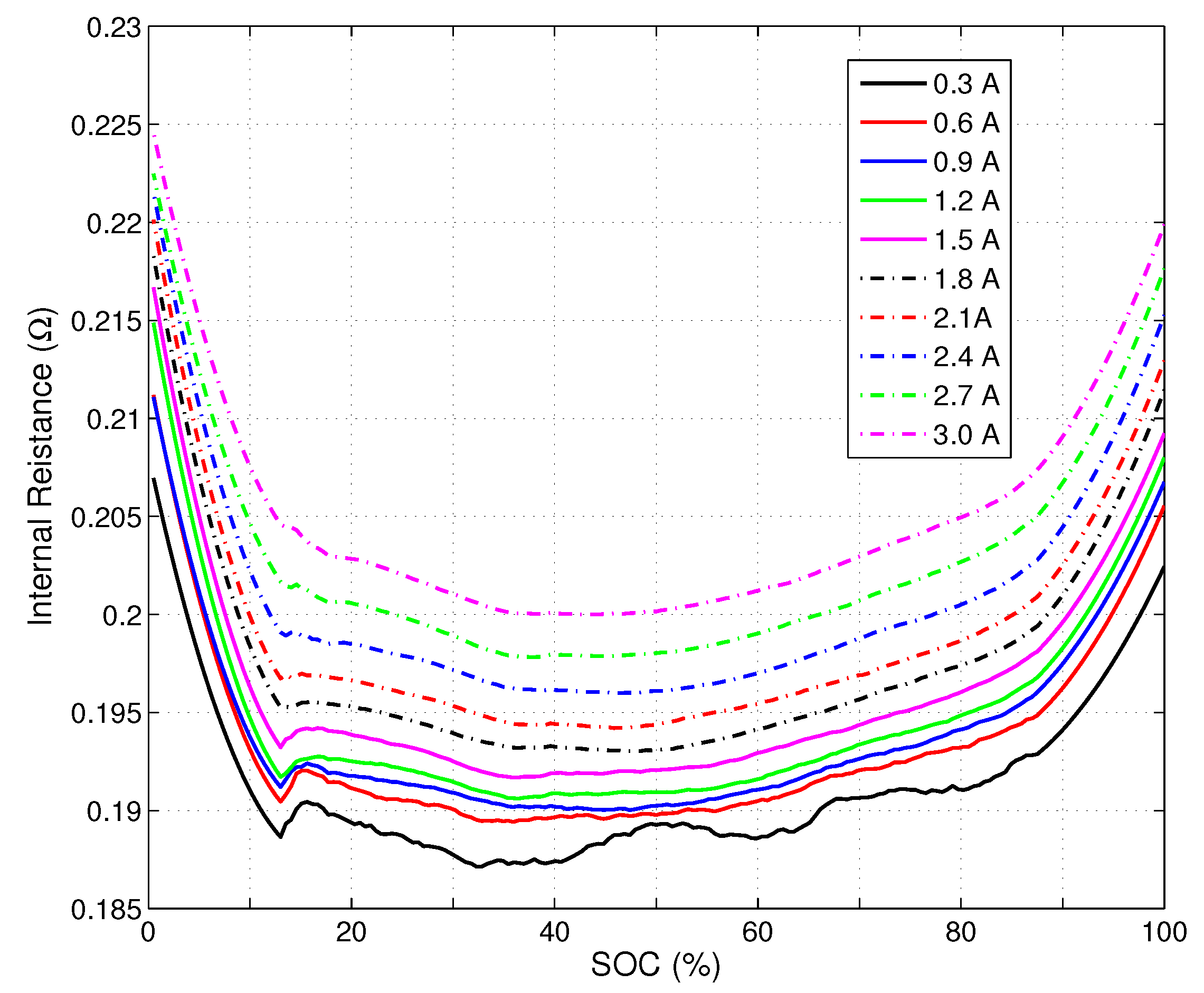

As the current rises, the battery's internal resistance increases, QUOTE]
I am no expert on batteries but are you sure about this:? My understanding is that as the current increases the battery will heat up due to increased power losses in the battery due to the internal resistance. The power loss in Watts can be found by multiplying the current squared by the internal resistance.
The internal resistance does not increase as the temperature of the battery increases due to the rising power loss, in fact I think the internal resistance actually starts to decrease as battery temperature increases.
This is why batteries don't last too long on the top of cold mountains, ie. their internal resistance is higher when they are cold.

The plots below show the relationship between internal resistance and discharge current.
The bottom black plot shows the resistance at 0.3A discharge, the red plot just above it the same cell at 0.6A discharge and so on for 0.9A etc.
Clearly, the resistance increases with the discharge current.
The cell internal resistance is the result of friction when Lithium leaves the negative electrode and moves to the positive electrode during discharge. When the discharge current increases, accumulation of discharge products and reduction of concentration of the salts in the electrolyte in the neighbourhood of the electrodes cause congestion and increase the cell internal resistance.
This phenomenon happens not only in Lithium ion battery but is common to a lot of batteries, it is called the Peukert effect.
https://en.wikipedia.org/wiki/Peukert's_law
Typical internal resistance of common Lithium Ion cells:
graphs from:
http://www.mdpi.com/1996-1073/6/10/5538/htm

yes, your battery internal resistance is higher at 0 deg C than at 20 degrees C but that is due to the construction of Lithium ion cells.
Your cells are optimised to functioning temperature at 25 degree C. That is, the internal resistance is higher too cold or too hot, lowest between 20 - 40 deg C, then rises again.
Your battery will heat up when you are using it, but you get quickly to an equilibrium, somewhere about 5-10 degrees higher than ambient temperature. This is seen with a 10AH battery, less with greater capacity like 13AH or 17AH battery. The effect of temperature is nevertheless small to insignificant compared to the Peukert effect due to the high discharge current.
Read the datasheet of the Samsung 18650 29E, probably the most popular cell on e-bikes.
https://eu.nkon.nl/sk/k/29E.pdf
Page 4 and page 5 explain the effect of temperature on the cell.
Page 6 explains also the effect of high discharge current on the amount of energy you get, 1C, 2C and 3C: 0.2C: 100%, 1C: 97%, 2C: 95%, 3C: 92%, the reduction is dissipated as heat due to increased internal resistance.
In order to understand why cell performance decreases with discharge current, you need to go back to the Arrhenius Law.
Excellent explanation Woosh thanks for taking the time to answer my questions. Absolutely love this site, so many helpful and knowledgable people here willing to answer our questions.
