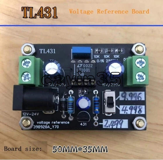

Could you upload a photo of the other side of your charger? I'd like to note which to avoid. I was faintly interested in buying a spare for my 36V battery, and BMS Battery suggested I buy this - is it any good? I don't know.
All of my cheapo DVMs have been reasonably accurate, tested with this (Package A).

Cheapos can be ok. The reference board I linked above is cheap, @saneagle's suggestion you quoted above is even cheaper.
Where is reference board then where you linked to also where is saneagles link
