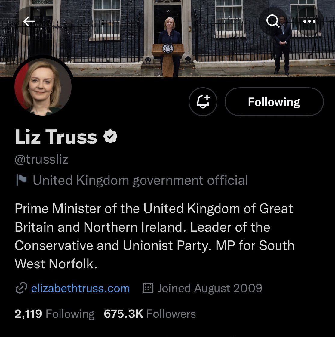

Fascinating ..Larry the Cat has 10,000 more followers than Truss!
What a world we are living in!
We are indeed at peak laughing stock before the world when the house cat at 10 Downing Street is more popular than the PM
Might as well get them to swop jobs (Though I doubt Truss could catch a mouse!)

Their reasons for following are likely also very different.
I suspect few follow Truss for any level of enjoyment, fun, relief, etc.
The big question is whether the majority of her followers are in any way supporters, or simply the rest of us in anticipation of a super gigantische Dosis von Schadenfreude.

Actually most follow Larry the Cat because his tweets usually make sense as well as being amusing
