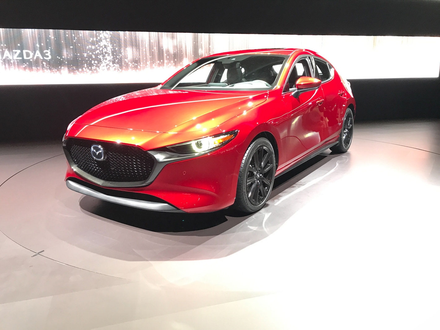

OT but Mazda new SkyActive engine promises performance of petrol with economy of diesel. Its a compression ignition/spark plug controlled petrol engine?? (new to me that one)
Sounds interesting... And folk want to travel by bus, train, bus and back again... I dont think so.
Get one in an MX5 and I, ll order it tonight.
They also do some silly one with a battery.
The spark plug enables a precise ignition timing point with a lower diesel compression ratio for smoother running. The compression ratio is probably low at around 14 to 1 or even 13 to 1, ratios which would give an imprecise ignition point on compression only ignition.
Very long ago Mercedes got near to this with the engine they designed for the first modern generation AUDI car, the model 100. It launched with an insanely high for a petrol engine 13 to 1 compression ratio, close to compression self ignition point, on petrol!
AUDI engineers later changed it though, by stages eventually all the way down to under 9 to 1.

So when is it compression ignition.
One of issues with compression ignition petrol is fact at anything other than full throttle the actual CR is well below theoretical and consequently too low to ignite, but if you raise it sufficiently to get around that at full throttle ignition is way too advanced. (severe pinking and engine actually firesbacjwards)
Only way around this is open throttle control as in diesel engines. (its one of reasons diesel are more efficient, ie more constant CR and less pumping losses)
Petrol engines have been available with open throttle control(I think TFSI is) but what I dont get is how Mazda can claim compression ignition but still with spark plug control. Surely its one or other. Once ignition occurs (either through spark or compression) a later spark is redundant. (Alfa have used twin spark, but they spark simultaneously producing bigger flame front)
The bit I dont get is spark plug controlled compression ignition? Its almost mutually exclusive???
The current sky active engines are running CRs bordering on compression ignition. (I, ve seen tuned engines continue running when throttle stuck wide open with HT leads pulled off, was a common occurunce on racing karts)
I, d like to see process and system involved in when engine is compression ignition and when its spark ignition??? Or how you control compression ignition with a spark plug. (on a diesel ignition timing is altered by delaying fuel injection, on modern ones anyhow) Wonder if they are doing similar but with petrol. But that would be called injection controlled ignition???
I also wonder if they are using massive EGR to increase ignition temperature when required.?? All clever stuff.
It looks that way, but it's the timing of the ignition point. Diesel compression ratios are usually in the 15 to 20 to 1 range, but for smoother running lower than 15 is better. Trouble is then the precise point of the self ignition becomes unreliable, subject to minute retard variation. The spark gives it a precisely timed point just as it is about to ignite anyway. That gives maximum smoothness, mimicking petrol.
In practice it may disappear after a while, possibly mainly a marketing gimmick.

Worth watching flecc.
In theory... If I understand it... The CR is such that compression ignition is at point of happening... Then at exactly correct timing a spark occurs, which under normal circumstances would produce flame front travelling accross combustion chamber, but in this case the extra pressure provided by local burning around spark pushes pressure for rest of mixture above ignition point, producing multiple ignition points and correspondingly faster burning. (and hence more pressure as piston not travelled so far)
They are making use of pinking.. encouraging it.. and helping it with high CR?? In a way its more building an engine that copes with compression ignition.. Not really what it says on tin.?
Just had a think..
If that process is going on in that engine whats to say exactly same thing isnt happening on any petrol engine. As flame front propegates through chamber, pressure will rise above compression ignition point before flame front fully through chamber, so every engine will do it to some extent.???
Personally think flame front will travel quicker than rise in pressure, pressure will be localised. Thinks its a gimmick. Nobody can disprove claim and its a great engine anyway.???
Its not really compression ignition. Its more probably compression ignition for some of as yet unburnt fuel/air.
