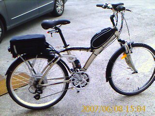

I've always liked the idea of a recumbent but the hilly route I do (please see route profile picture - hopefully) and the visibility required to 'make progress' through slow or stationary town centre vehicles means it doesn't suit me as a concept.
I'm coming down on the idea of a kit + urban bike (see Cannondale picture). Chuckable through traffic and shortcuts (always legal...) and hopefully the best compromise.
As for comments about not caring so much about what it looks like. Personally I like my 'toys' to make me smile when I see them. My motorbike hurts my neck, forces me into a crouch, can lose my licence in 2.7 secs, gets too hot in traffic, is geared for speeds that I never use etc etc but everytime I see it in the garage or use it I'm glad I didn't get the sensible commuter option with helmet box (and yes, I have got matching leathers !!)
Thanks again. It would be boring if everyone bought the same things....

I can't really think of a kit converted bike that really looks that 'good' when done though, DDmouse, so how will you get around that?
Stuart.
DDmouse
Nov 19, 2007
7
The Bionx 350W kit looks fairly subtle I think - spray the battery pack to match the bike. And with the curent $ to £ exchange rate fairly well priced.
And I get an LCD display with 'engine management' that can be hacked...
