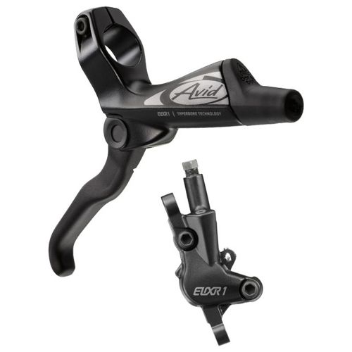

I've been thinking. There may not be enough room for one of those because the reservoir runs parallel to the handlebars. It'll probably be OK, but If you can show a picture of your handlebars, we can advise the best brake. Some of the Shimano ones go more at right-angles to the bars, so don't get in the way of changers, throttles, etc.
This is the Avid one:

it's not a problem for John F's santana because he has index shift but I can see you have revoshift and thumb throttle already on the right grip. If it's too crowded there, what if you swap side (hydraulic to the left) in case you have only one hydraulic?
