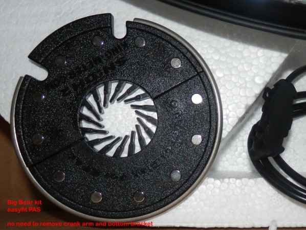

that's pretty good, the motor, battery and LCD are OK but I guess you'd want to know what can be improved.
1. you've got Tektro Auriga hydraulic brakes, the selected brake handles are useless.
2. You've got Truvativ crankset, it's very difficult to fit the selected pedelec sensor on them.
the PAS disc is also inferior quality. You should go for 12 magnet double hall disc, does not cost much. Something like this one from the Big Bear kit

that model of PAS is not bad, the holes on the disc will collect mud though.
