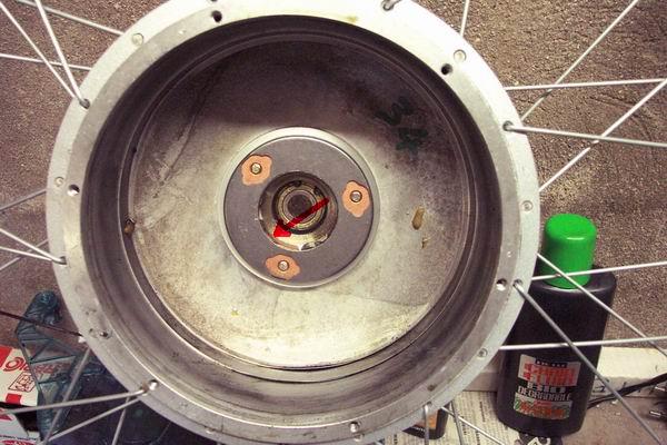

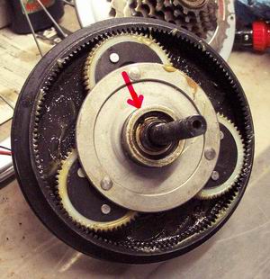

Hope I’m not OT (but I think not…).
Speaking about the drag problem of the hub motors, a friend of mine let me known that perhaps there is a system that avoids that.
If you look at that hub motor,
the black hinge (please forgive me for the wrong techical terms!) doesn’t move, while the small cylinder marked with an arrow rotates inside the cavity shown in the second photo;
inside the cavity there are some small pistons acting as a freewheel: in such way, when motor is off the orbital gears stay still.
Does it make sense? And in the case, is that a special feature of that italian pedelec?
53,546
30,840
Yes, rotation locking systems like that can be used Leonardo, but most rely on one freewheel between the motor and the gear drive, so although the motor is disconnected, when the wheel turns the gears must turn too. A few don't even have one freewheel, so everything must turn as the bike rolls, and that's the case on regenerating systems like the BionX and the new Twist.
Even where there's full disengagement, the unsprung weight of a front hub motor does spoil the cycling experience to some extent, compared to a normal bike, and rear hub motors are better in this respect.

It is a quite old brush motor of an Italian pedelec called frisbee. Now they have brushless motors. It should have also a second freewheel as described by flecc between the motor and the gear drive. It is quite a good and powerful bicycle, one of the most widespread in Italy, but unfortunately heavy and with an old styling.

I could see it was heavy Leonardo, and that's another reason why that decoupling refinement isn't commonly used, it can't be done without weight. Many of the modern hub motors are carefully designed using sophisticated CAD techniques to have just enough strength for the job, with weight saving in mind, so extra weight is avoided as much as possible. The power to weight ratio of motors like the eZee Quando/Torq one is very much better than that of older designs.
