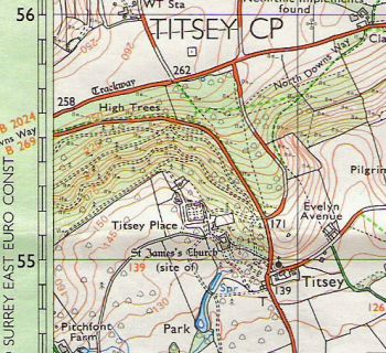

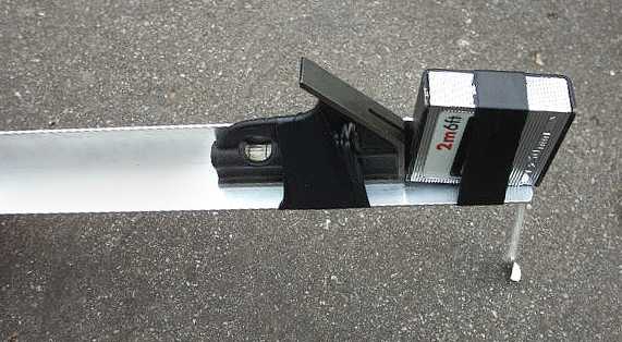

Come off it! There's plenty of 25% in the UK and I have some I've ridden in my immediate cycling area. My steepest is just over 30%, I only managed it once and it nearly killed me. And I have accurately measured their gradient, see this link and the image below which is no longer in the original post:
But they aren't long of course, only taking a few minutes to climb.
Continental standards are very different of course, the roads usually much better engineered. It always amuses me when someone speaks of Alpine climbs as being steep, when in fact 7% is commonplace and over 10% rare.
Our more recently built roads are similar, but much of our minor road network is little better than surfacing what was once tracks and sometimes ridiculously steep. Here's a couple of local map images with contours I rode regularly, typical of so many UK lesser roads. Three climbs in these two maps are described in this link, together with a short 25% example.
Reactions: Nev and RobF
