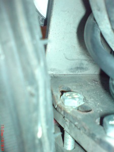

Yesterday I rode my e-bike and jump off some sidewalks. Not anything special.
I've a Dahon bicycle with a chain drive conversion kit. The motor is places just below the crankset, really close to the ground:
This piece of metals that is attached to the frame got hit and slightly bent.
Now, whenever I'm trying to pedal the pedal is touching the motor because of the bending:
Does anyone had such a problem? Is it common with such low placed motors?
And where the hell can I find a new metal instead of the bent one?
I've resolve the issue so far with a really high-tech, clever and amazing tool::p
A Wrench!

Your motor system is a Cyclone by the looks of it Roni, see if Paco at Cyclone can post you a new bar:
Cyclone Taiwan
sales@cyclone-tw.com
Alternatively a local engineering company could easily make a new one or maybe straighten the old one.

A bar, that's the word that I was looking for! I forgot the word in english for a piece of metal:)
Yeah, I know it's Cyclone, it's just that I've bought the kit from a local dealer who want to charge me a ridiculous amount of money for fixing/replacing it.
Anyhow, thanks, I will try to improvise something by asking some eng company to prepare a new bar for me.
Just wanted to know if it's a common problem with such low placed conversion kits.

It's a bit of a trade-off, whether the mounting bracket will bend first, before the frame it's mounted too. I suppose it's less of a tragedy having to replace/repair the bracket once in a while rather than scrap the frame, if the damage or twist is bad enough.
If it was doing its job well enough before the kerb encounter, I wouldn't re-inforce the bracket, for the above reason. Just stay clear of kerb jumping.

Cyclone quality does leave much to be desired, but as Scimitar says, parts can be deliberately sacrificial to save more expensive items. The better bike stands that bolt to frame brackets are often deliberately designed to break first before the frame.
sorry, but what i see it is´nt a cyclone. The picture is not relly clear for to identify the motor but what i see is a "unite" motor, it is a 25Euro e-bike-motor from China, with a freewheel from other company.
BTW, why you dont make a bar by yourself? this mounting bar dont look complicated and i would guess that everybody with two hand and a vice in his basement and a drill can do this by himself
Before i would pay some money for the same shi... and wait 1month, i would do it by myself or you go into the next machanic garage and pay maybe 40-50Euro and they make a better copy as it is in original.
regards
frank
PS: you can check the motor on my website cycle-motor.com scroll down and look the motor in the right corner, is it the same?

Thanks Frank, I noticed it looked very slightly different but the mounting was the same method of course.

I had another problem with my bike two days ago. Now it was a more serious one. (I've fixed the bar problem BTYW, wasn't that hard after all:) )
