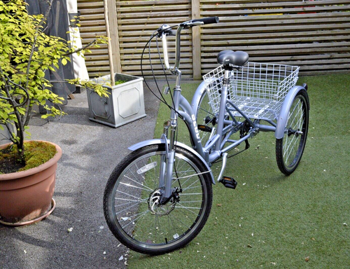

scout trike

no idea but there are two black round metal things with keys in to stop the rotor and crassest moving

If you're going to convert it to electric, would six gears be enough for your aunt's uses?

Best leave it as it is, six lowish gears is plenty. Narrow based trikes like this are notoriously unstable, tipping on turns at the slightest excuse.

not even my bike guy that has worked in a shop for 20 years has not got a clue either if she get used to it ill think of a front hub kit for it ;)

Adult stabilisers, to prevent her keeling over?
@peter.c complained about his trike, in this regard.

tbh it is pretty stable as it is heavy and spec says max 200kg :rolleyes:

Many people simply cannot get used to steering an upright trike, especially true of experienced cyclists. It's the reversed steering combined with the sensation of tipping they are unable to adjust to.
On a normal bike which banks, we subconciously steer slightly away from the turn to allow the lean, but of course an upright trike has to steered into the bend direction. Which can just feel very wrong.

That's even worse, if circa 150 kilos of rider perched high up on the upright trike. You'll see when you ride it, ok at low speeds but can get very scary into turns as speed rises.

she is 74 and saddle low as it can go the trike is about 26 is kg and max load says 200kg but the basket is held together with plastic clips.
cant balance any more so that or mobility scooter.

Don't forget that you steer the opposite way on a trike. On a trike you turn right to go right instead of left to go right on a normal bike.
