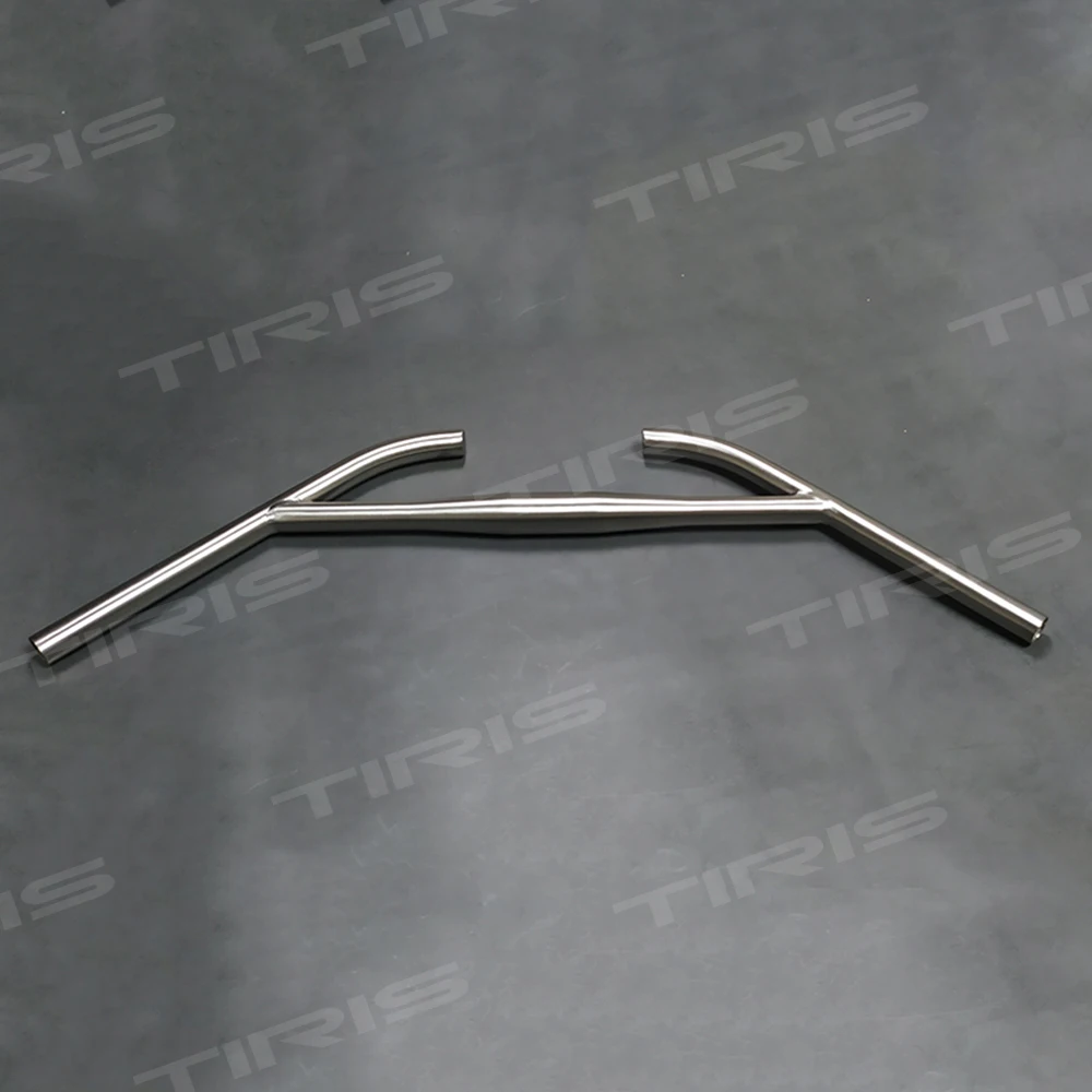

The trouble with bags like that, at least on my bike, is that they crush front cables, which is why this handlebar looked interesting, but I've read reports that they're too stiff:
There's a cake carrier (or biscuit) accessory for it:
These wouldn't be as stiff, but are a lot more expensive:
Reactions: Bikes4two

Thanks! When I found myself looking at those hoop handlebars, was the first I'd heard of them. Good prices in their outlet.
Really are bargains on the USE site. carbon risers -£20. Straight carbon bars - £15 These are heavily reduced prices obviously.
https://www.exposure-use.com/Brands/Ultimate-USE/Outlet-Store/ATOM-Rise-Carbon-MTB-Bar-ATOMR
I bet those get snapped up before I've decided how quickly I'd end up destroying carbon by overtightening lights, cameras and action. Bargains! I need oodles more space for more switches and gadgets, hence my interest in hoopiness. But very very tempting...
Some reasonable savings on their Exposure lights - Im currently trying to decide on whether I'm buying a Maxx D or a Six pack to add to the Toro I currently have.
Both of those look very bright in reviews - are replacement LEDs available? I've noticed one of my 1800LM headlights lowering in brightness after a year's continuous use, yellowing a bit too.

I tried a carbon handlebar extension... it was marvelously lightweight, but there was a limit to how much it could be tightened, before risking cracking the bar and/or causing asymmetrical deformation with the force of tightening the clasp gripping the carbon, the end caps popped off and couldn't fit back in.
Then, after a long 4 hour ride in heavy rain, it and the cellphone holder it was holding swivelled down, wouldn't stay up no matter how much I tightened it. Mind you, everything else held by clasps and bolts swivelled around downwards or slipped down, including hilariously, my steatpost and seat. But there'd be less RF interference.
I bought a Minoura aluminium extension bar recently, which appears to have a beefier clamp to the handlebar, but from what I've read, I'm unsure whether that will stay in position after being exposed to long periods of heavy rain either, but I think it's unlikely if something like a phone or tablet plus a light is clamped to it. Which furthers my interest in handlebars with welded hoops.
