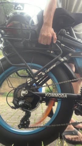

Might it be the orange reflector in between the spokes? If you think it might be, just temporarily remove it and re-test.

So its not the orange reflector, I removed it and the issue still persists.
I have checked that the motor plug is not easily accessible, I think that is inside the frame. Will check this once I got time.
The noise is still there when I turn the wheel manually and slowly without me turning on the motor.

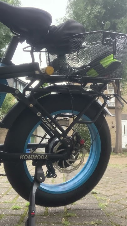

I have received an email from the manufacturer, and they said that it might be something to do with an imbalance in the motor, is this easily fixable and can it self-adjust given time?
20,917
8,533
61
I would say it is rotor screws that are two long and agrre with d8veh.
There is nothing inside that can cause that noise otherwise.
With the rotor screws if too long they will catch and rub, causing such a noise as they hit the revolving motor innards.
The noise isn't a common motor or electrical fault but a wearing rubbing noise so one has to look at the obvious that will coincide with the rotation.
Reactions: Bikes4two
griefter77
Aug 24, 2023
6
They're talking ballcox. Did you check the disc screws? How did the noise start? Did it do it from new? What changed to cause it to start?
I have checked the disc bolts and it seems that they are directly integrated with the motor? Do you suggest that I loosen it or? I also made another video showing it from the other side and slower
6,818
3,152
The screws are in spiggot , so it won't be them that's causing the problem. if only you guys would give us information in the first place, it would save a lot of time and effort. What about answering the other questions I asked.
Undo the two brake caliper screws and lift off the caliper. See if the noise goes away. Also check that the disc screw heads aren't touching anything.
The rack bolt looks pretty close to the disc too.
