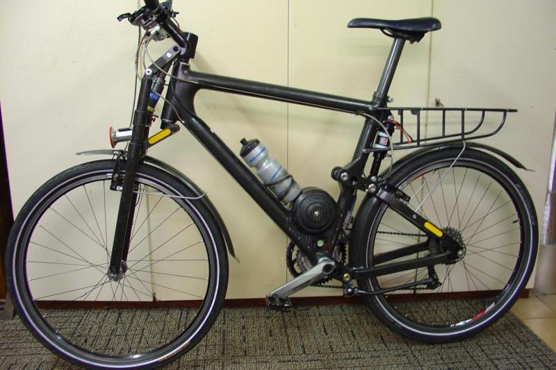

The Torq problems aren't all universal.
The Li-ion cutout problems aren't experienced by those in flatter areas, and those owners also get longer lives in consequence. (battery that is, though they may also live longer without the worry :) )
Likewise, the high rider gearing doesn't worry riders in flatter areas, or the riders of greater cycling ability who the machine is really intended for, and it didn't particularly worry me for my routine hill climbing up to 14%. It just cut out a couple of leisure routes for me.
The front brake judder is far from universal, indeed I've never experienced it on my Torq/T bike, though I did for a while on the Quando but with a different cause. It seems to me that only a fairly small minority suffer it. Brake judder also occurs quite widely on ordinary bikes and has been a fact of cycle trade life since the introduction of alloy rims and soft compound brake pads/blocks some decades ago. It was almost entirely unknown with steel rims and hard brake blocks.
The harsh front ride is universal but different riders perceive it differently. Anyone who's ridden race style bikes with skinny high pressure tyres will not be affected by it much since a hard ride is a fact of life with the tiny section 120 lb pressure tyres they have experience of. Conversely, the many who've usually only ridden low pressure fat tyre sections, often on MTBs and the like, and sometimes with suspension, can be really shocked by the Torq's front ride hardness. As we've seen in the forum, those who suffer RSI or other wrist medical conditions are obviously extra sensitive to it. It didn't worry me, but I swapped the motor to the rear to see how much difference it would make. It did make a difference, but since it didn't worry me I threw away much of the gain in favour of the performance advantage of a skinny high pressure front tyre. Many wouldn't do that of course.
The fairly weak rear roller brake is universal, but again is perceived in different ways. Those used to this type of brake who use the rear brake just for routine slowing and add the front for more urgent stopping needs aren't worried by it, and that included me. I changed mine only in the T bike version to cope with it's additional performance. Heavy riders notice this rear brake more since it's already close to it's design limit of 100 kilos gross with a moderate 70 kilo rider.

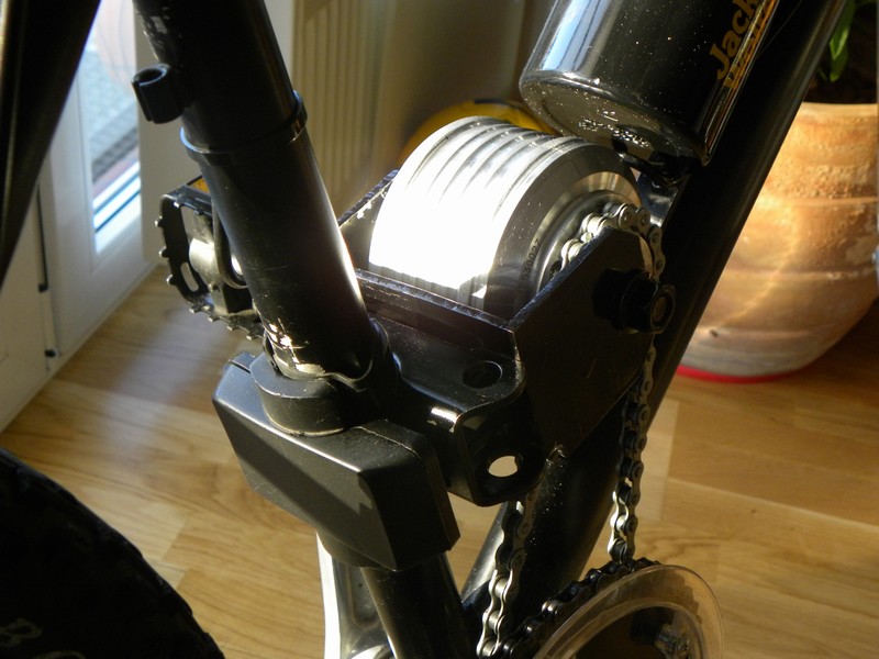

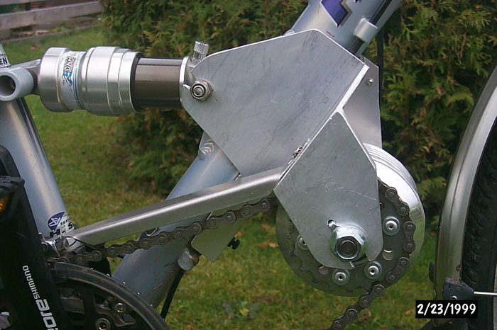

Cost was very small John, a pair of Marathon Plus tyres discounted to £40, a multi sprocket freewheel at £9.99, an Acera rear mechanism at £14.99, a twistgrip gear changer at £8.95, a hub to scavenge a freewheel thread from at anything from £15 to infinity, rear V brake at around £20, new chain and an assortments of odds and ends for no more than £30. Say as little as £140.
But as I said to Stuart when he thought of doing the same, easier said than done, and there are some risky procedures involved which no-one would commercially undertake. For example, running the Torq motor flat out with the bike upside down to use it as a capstan lathe, while using an angle grinder to accurately grind off the steel bearing housing extension and part of the alloy shell, and driving the bearing inward at the same time after previously removing an internal washer from the motor. Then there's making the spindle strengthening adapter
These milling operations could be done more delicately by an extensively equipped engineering company instead, but they'd want engineering drawings first and charge the earth for doing the job, and without being electrically skilled your rotor assembly and lead out wiring would be at considerable risk. In fact it would be as cheap to start with a new Quando motor with it's longer spindle. I don't know how much that would cost, but probably around about £300 as a spare. Then add the spindle strengthening adapter cost for manufacture, a freewheel thread converter made by a specialist company like Highpath for about £100, plus the costs of an engineer who was both electrically and cycle conversant to complete the assembly, wheel offsetting etc. Add the previous £140 and you have a total of around £800 minimum including the skilled labour, plus a Torq, so £2000 new.
Not much point when a Forza with similar performance costs £1400, less whatever an existing Torq is sold for. This emphasizes that it's only practical for someone who has the necessary skills, the appropriate equipment, and the willingness to take potentially costly risks to do it on a budget.
