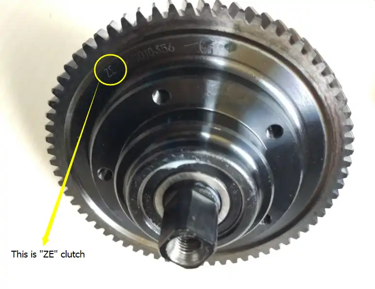

Here is a typical gearbox inside a Bafang motor. The ballbearing in the centre is a one way needle bearing, acting as a clutch. CD motors have two, hub motors need only one.
20,639
17,015
CD motors have two what?
two clutches, one for the motor (so called the primary reduction gear on the BBS01 and blue gear on the TSDZ2, same as the clutch on the hub motor), and one for the bottom bracket / cranks which is found in the middle of the main gear cog.
20,639
17,015
the one next to the motor's spindle is the white nylon gear (called the primary reduction gear). The other is built into the centre of the large main gear, you can rotate the cranks backward without turning the main gear but if you turn the cranks forward, the clutch latches and turns the main gear.
You can see the main gear clutch here;
white nylon gear:
