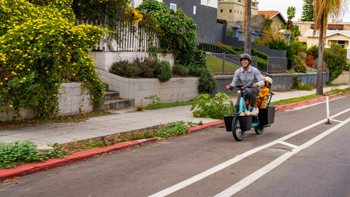

I asked about your budget, because there are bikes on the market designed to carry children. Yours is not. Have a look:
