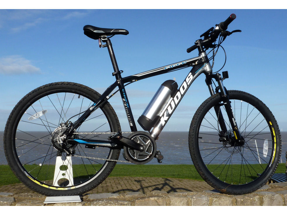

... that I can have an ebike (just a dream at the moment).
My regular ride would take in a 20% incline (so the Woosh site tells me) and I can only pedal very gently, due to a knee condition. I read that centre drive is best for hills but does this still hold true if you can't pedal very hard? I definitely need a throttle, so that I can stop part way up a hill and then restart without first having to turn the pedals around (I can pedal once it's moving, just not with a lot of pressure).
I weigh 8st 2lbs (inside leg 29") but would be carrying shopping up the hill. I'd expect most journeys to be less than 15 miles total.
Wheel size needs to be 26" or more.
Can't think of anything else at the moment. I don't have a budget yet.
Thanks :)
-H

Any of the Woosh CD bikes would do it, or the Woosh Big Bear or any of the Tonaros. There's other bikes too, but slightly more expensive.

agreed. The Tonaro Compy is on special offer @ powerpedal at the moment
£1000 Compy:
Reactions: Helen C

then again, the £799 Santana-CD can do pretty much better (bigger battery):
Reactions: Helen C

do you mean this £1,399 Volt Pulse?
it won't get you up 20% gradient on throttle alone, you'll have to pedal quite a bit for that and you said at the beginning that you can't pedal very hard.
The Volt's hub motor has a similar response like this Woosh Big Bear, it will climb 10% hill on throttle but not 20%:
http://www.wooshbikes.co.uk/?motorcharts
Woosh Big (polar) Bear:
Reactions: Helen C

the Volt pulse has an 8-Fun motor, it looks like an 8-Fun SWXK5.
The problem is low motor efficiency at low speed. The hub motor is perfectly good up to 12% gradient (12% for BPM, 10% for SWXK5), then becomes inefficient quickly for anything above.
The crank drive is better in this respect. The Sirocco CD (8-speed 11-34T) can climb 15% on throttle alone. I guess the 36V 25A BBS01 should be good enough to climb 20% hills on throttle alone.

It was the lower power one, but I only rode it on the flat. I hadn't realised just how steep the hill from the shops is until I used the Woosh predictor. The steepest I tried on the Powabyke was 12% - and I managed that fine (pedal & throttle together) but I understand now that a hub drive just won't do the 20%. Thanks to all for clarifying this.

definitely yes, it's one of the best bikes currently on the market.
