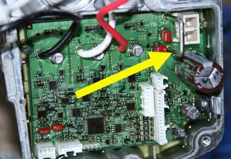

This surprised me when I opened the controller. It was the first I’d seen without the classic shunt. Guess I’m outta touch these days
The integrated battery controllers are compact Kirstin, some are potted in silicon certainly on the underside and use tiny compact solid state components, though cap cans are still present.
The dolphin 09 controller is a double decker but so compact and tiny pcb's.

Looks like this type of integrated controller has a shunt. Whether it’s sensible or to solder is another question though
Panasonic did things in reverse with their crank units. The first series from 2001 had no shunt but the second from 2006 had a useful shunt for soldering:
