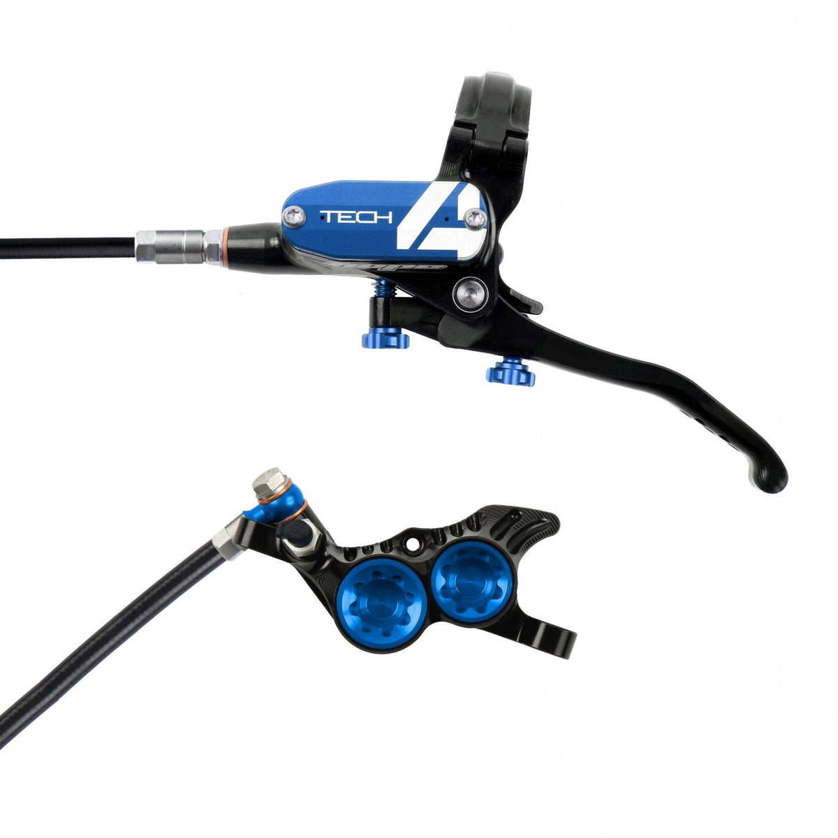

If you fancy getting spendy, latest Hope tech4 V4(orE4) are probably in the top 5 most powerful brakes currently on the market. Been compared to trickstuff direttissima power wise.(Trickstuff make the best brakes for bikes)
A bikes worth inc basic rotors will set you back about £500
I've these(V4) on my EMTB, and also on my non E bike, and they really are a hell of a stopper.
