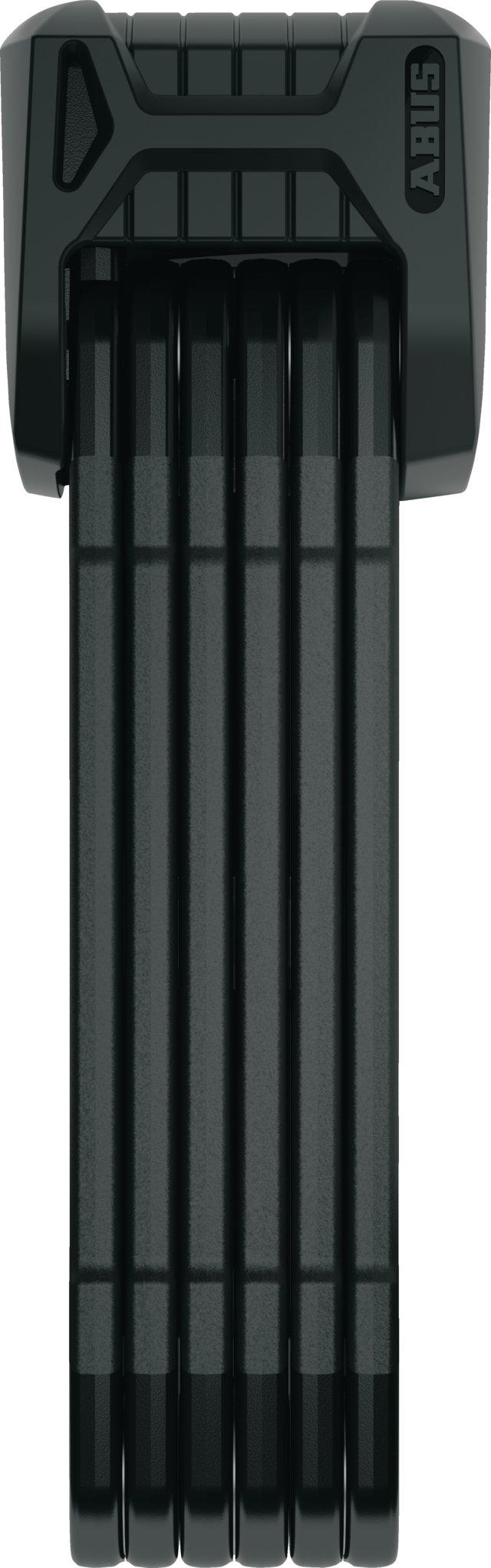

I use an abus bordo granit lock, along with a kryptonite cable to feed through the wheels if i go to town. 99% of the places I lock it you just need a main lock, and only use the cable if im in the city center, but even then its not for that long.
If youre intending to leave it for extended periods, look to remove the front wheel and lock that to the frame using something like the lock in Guerney post above. Heavy yes, but better than losing the bike.
NOTE- No bike lock is secure enough to withstand a cordless angle grinder(ok there are some but theyre too small to lock the wheel through ,are really really heavy and cost £250)
So follow some golden rules about where you intend to lock it, ie in plain sight and not down some shaded back alley or god forbid overnight.
