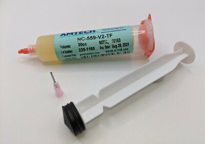

will experiment with dissolving rosin flux in isopropol, to apply using a dropper.
i did that and it drys out and goes rock hard again its ok for cables but not pcb work as then a pita to get off.
it is not cheap but makes it so much more easy to work with.
I've ordered some of this:
