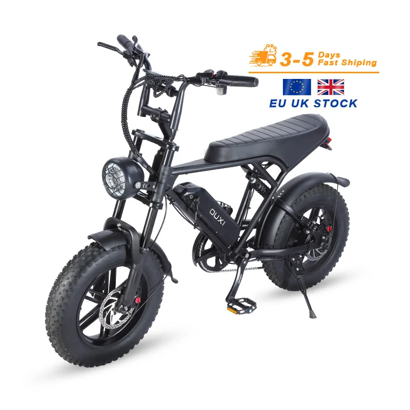

I have a 16 inch fat tire ouxi v6?
Originally the Amazon ad said Qmwheels. My purchase history now shows a different bike altogether now. This is my main source of transportations.

Hitting the steps might have jolted a connector, so if any wiring is exposed and you can see connectors give them a wiggle and check tightly fitted. The motor cable for example. If the battery is removable then remove and refit and wiggle.
Check the throttle is definitely fully closed.
It looks like a bike from a scooter manufacturer so components may not be the same as most bikes.
Also 500W, so not legal in UK, and listed at $300 or so on aliexpress, so rock bottom cheap, so customer service unlikely to be good.
