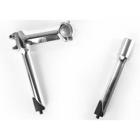

There is a folding handlebar stem extension for the Espresso, which folds over backwards to the left at 45 degrees, tilting the handlebars to the side for a narrower folded bike profile... therefore fitting wide hoop trekking handlebars as linked below is an interesting possibility. The additional bar looks ideal for ebikers forever running out of space for lights, displays, ever more switches etc. (might just be me lol). Simply tilt the lot over when folding the bike - no need to add handlebar extensions, many of which turn and droop in the rain. I suppose the narrower folded profile afforded by the barmy 50cm handlebar this bike arrived with, was the reason why they were fitted, allowing this Espresso to fit into a car boot folded, without having to unscrew bolts to turn the handlebar every time. My main reservation, is that the folding mechanism adds two inches and a bit to handlebar height. Also, I wouldn't be able to fit Redshift handlebar suspension, which @Nealh said was quite good.

I'm not sure if the Espresso is the same, but my matrix has an NVO stem (https://foldingbike.biz/epages/7665e38c-067c-4fa0-9037-afac2266f927.mobile/en_GB/?ObjectPath=/Shops/7665e38c-067c-4fa0-9037-afac2266f927/Categories/fcd04e26e900e94b9ed6dd604fed2b64/NVO_Handlebar_Stems&Locale=en_GB), which means you can loosen the stem bolts and then the whole stem/bar assembly comes off without having to adjust the star fangled nut.
Very interesting, thank you for pointing the NVO stem out. I'll ring up and ask them about that.
It looks likely to me that the fangled nut would need to be removed (if one is installed), before this folding handlebar gizmo can be inserted:
If I buy a new fork and frame, they'll be shipped unassembled. I really don't fancy installing the fork myself, because of the horrible consequences of getting it wrong. Luckily my local bike shop is very local, unluckily as usual he'll rob me blind, but luckily he's thousands of years old and knows his stuff. His shop's been there since 1890.

That folding stem is an old style quill stem rather than a modern Ahead style. They are not interchangeable, so it will depend what type of fork you have - threaded or not.

White's did seem to think the folding mechanism and Espresso fork they have for sale are compatible. I love the idea of a folding handlebar, I don't think I can resist at the very least trying it, because it's an ingenious design which means I can get away with using ludicrously wide handlebars for stability and all my gizmos, yet the bike could be quite narrow when folded. A more upright position could make a nice change from crouching, but I suppose if I didn't like it, I could replace the handlebar folding mechanism with something else (or from the large Espresso I have, Espresso fork design changed over the years, I was told the newer ones use Ahead). I don't know if stem adapters are any good:
