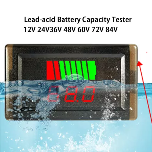

ebay or its alternatives are probably the best source for a cheap volt meter (£2-3) or you could get a more detailed DC power meter for £12+
(ebay search 'dc volt meter 60v')
ebay search ' dc power meter 60v'
But you may need to retain the 'broken' display and keep it attached as generally settings such as speed limit wheel size pas sensor settings etc are set and stored in the display unit and passed onto the controller at system start up..

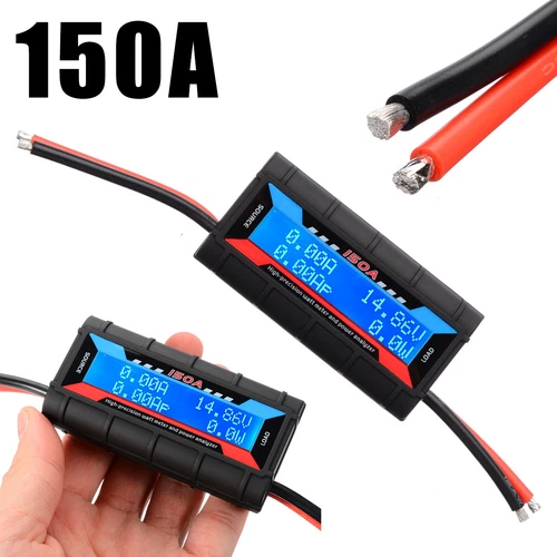

Fit a wattmeter between the battery and the controller. If you want it up on the handlebars to see it in real time, which is very useful, you have to buy one with a remote shunt. You can get them from Ebay. Whichever one you get, make sure it displays AH or WH.
With remote shunt:
