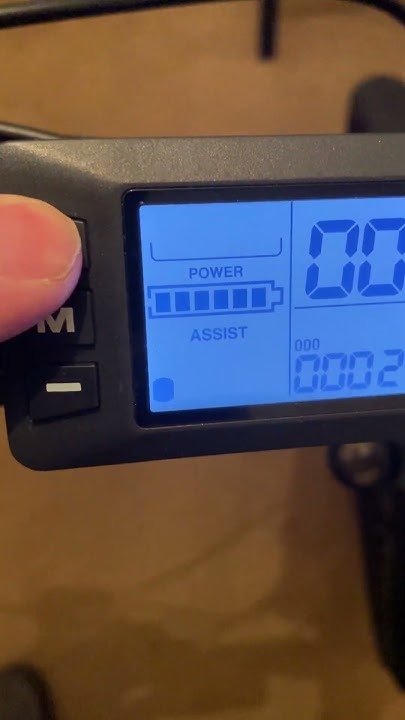

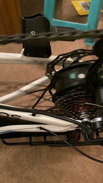

Well I was just out on my bike, and I lifted the back wheel and cranked the pedals but couldnt see motor spinning But it works ok on throttle, and i cant see any wire off or loose. I am taking bike into my flat later to check it out more

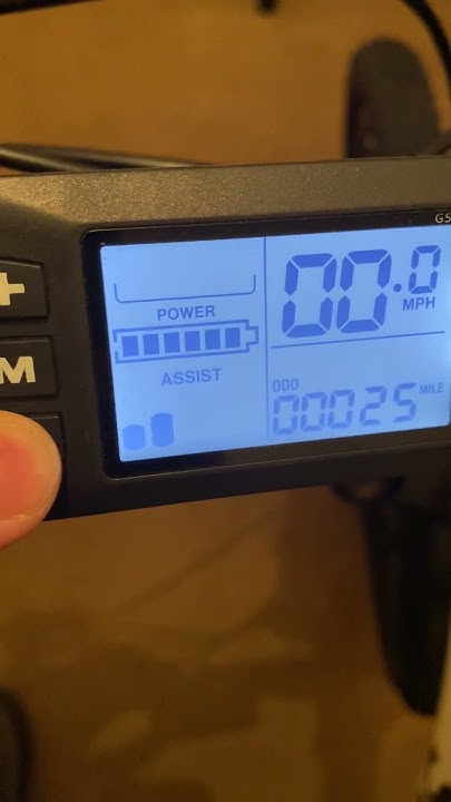

Well Nealh it is true what my brother said about his Cyclomatic electric bike. he has a switch to turn on and off PA. mine is the same too as I have just realised on the G51 control panel if you press the PLUS + sign it increases PA to 5 as it was on 1, and if you look at videos below you can see PA is working now on 5, and if I say press MINUS - and so there are no marks on control for PA it turns it off, as you can tell by the wheel rotation
NO PA
NO PA ON CONTROL
PA 1 to 5
PA AT 5
