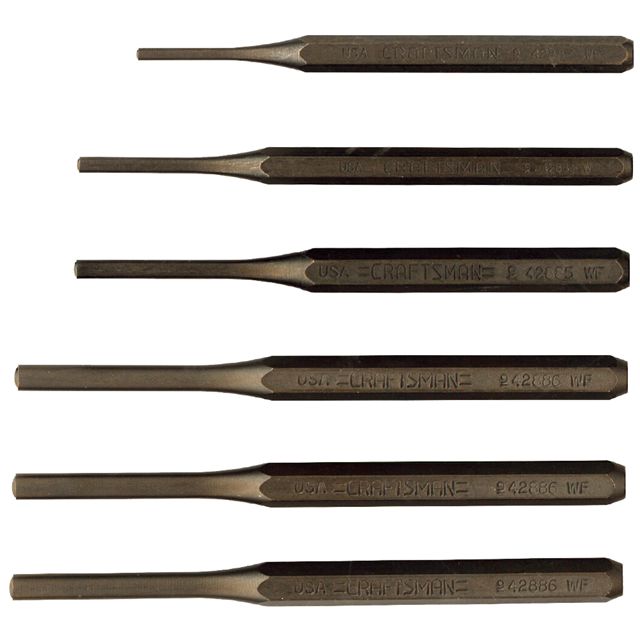

Thanks trex - tried that to no avail. Also tried making a tool but used a type of epoxy resin putty to form the four teeth - under a heck lot of pressure they sheared off
Grub screw .....ahhh , didn't check that ! Could be my issue . Will check this eve when I'm home

Bugger - I've trashed 2 grub screws - they are nearly sideways :(
Maybe I can drill them out but then it will be ruined for future use
