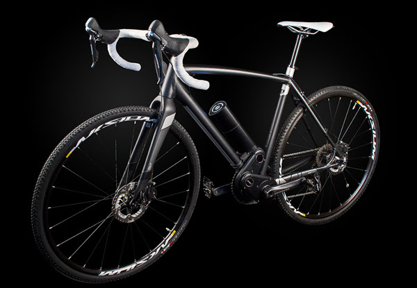

Here at last is a little electric help that you can add to your existing bike.
We’re offering FREE FITTING for the first 10 people that make an appointment to bring their bikes to our store.
Don’t worry, if you can’t get your bike down to us the product comes with clear pictorial instructions.

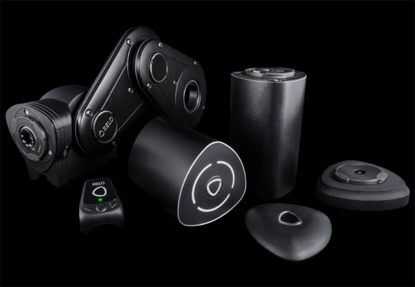

THE REMOVABLE DRIVE UNIT
The first removable drive unit ever for a bicycle is the upgrade your bike needs and weighs only 3.7 kg – including the battery.
The great thing about it is that all bicycle components remain in place, and the motor and battery can be snapped on and off at any time with a simple hand movement.
Only the gear box weighing only 1.7 kg remains mounted on the bike.
Your bike remains your bike.
It’s up to you to decide how you want to ride:
with the extra power of a 250 W mid drive motor, or no drive motor at all
– for pure cycling fun.
The base package contains everything you need for the upgrade of your bike: Gear box, motor, battery and charger, Bluetooth LE thumb switch for wireless operation on the handlebars, and cover for the gear box.

Thanks Gray, that's certainly interesting and a potentially better quick removable drive than the powered integrated wheels. Perhaps too expensive though, might as well buy an e-bike for the £1500 to add to one's unpowered bike.

My god they are delivering! I first saw this in 2015. I like the concept, not the price but it is German and only costs a bit more than the price of a Rohloff...

I love their Bluetooth switch for the handlebars. I wish some Chinese guy would get that idea too and make a controller with one.
Cheaper solution: HL battery with integrated Bluetooth controller (rumour has it one exists...) and a rear wheel hub motor. When you want to ride a normal bike you swap out the rear wheel and take the battery off. Torque arm and axle would need a little improvisation maybe? All that is left on the bike is the battery holder with controller and the wire back to the motor.

Why didn't they provide the option of a proper battery? 100WH will barely get you up the first hill. It doesn't make sense when a 20 x 18650 battery gives 36v, 226 Wh and only weighs 1 kg. Why would anybody want less?

Lots of Germany is flat and practically all of The Netherlands, they are the people who will fork out 1500€ to kit an existing bike. That is my guess. They seem very keen to sell you several batteries so I guess the margin is more comfortable on a teeny battery that is not of much use out of the flat lands.
