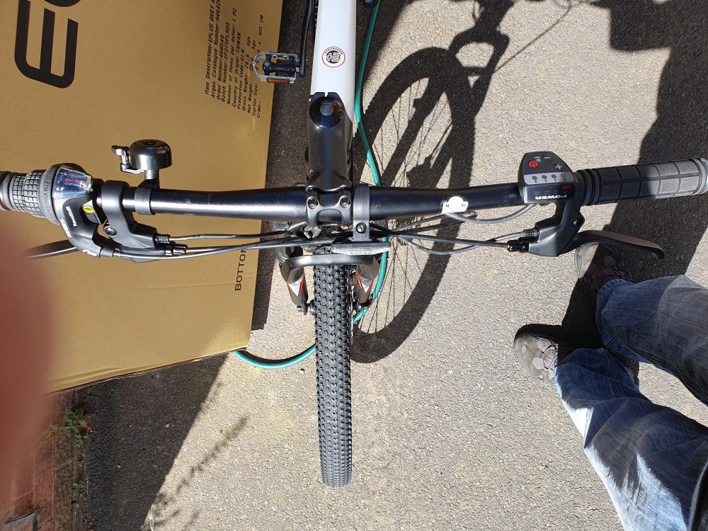

It's an Akezbike, I'm unable to find the exact one online, I'll upload a picture.
Display is KT LCD5
Battery is a HL Downtube 48v 13ah 750W
Controller is a KT36/48ZWSRM-AKZ01
The motor/hub has nothing on it to indicate the model.
