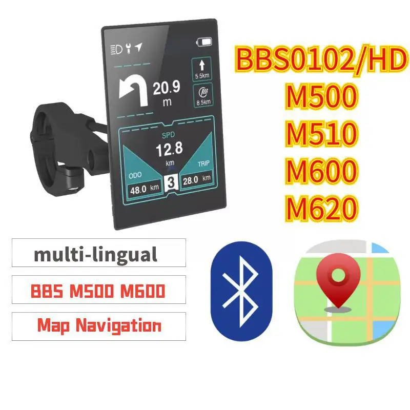

Hi all
I enjoy touring and currently use my phone and Komoot for turn by turn navigation with pre programmed routes with my phone mounted to the handlebars. Works well, but issues when it rains, having to remove for security when stopped and battery life of phone.
I've been looking at the new Bafang displays for BBS mid drives that have built in Bluetooth and navigation turn by turn indicators etc on the display.
From what I can tell there are 2 or 3 models, a couple of larger screen ones and a smaller one here
About £35 delivered
They link to an app called BikeGo via Bluetooth and theres a mapping feature
I'm thinking of taking a punt and ordering one, but before I do has anyone had any experience of these displays?
Cheers

It's a nice idea but another device to carry about/charge/worry about getting stolen?
are you referring to these new Bafang displays? They are secured to the bars, powered by the ebike battery, same display to control the motor settings etc so nothing to remove, secure or charge..and waterproof, so not sure what you are on about...?

trevor brooker
Feb 11, 2018
284
158
maidstone
looking at the pictures if you pair your phone to the screen then the screen will display left/right arrows, whereas if you use a phone you will have a map & directions.
Also it uses the current Communication Protocol:Uart so is not backwards compatible with the old style motors.

1. the Bafang display is waterproof, IP rated, all ebike displays including the proposed one are rated to be used in the rain ,my phone isnt
2. I wouldn't want/need to remove my ebike display, it is secured with a nut/bolt onto the bars, my phone is secured only on a garmin mount, one twist it's gone, hence I would need to remove my phone every time I leave my bike unattended
3. No need to charge the phone, if not using it to display maps, navigation etc, the screen is off and in my pocket, doesn't run down like it would if it was on showing me directions etc as the Bafang display is doing that

I'm beginning to have doubts that the app/maps behind this are up to the job yet. The beauty of Komoot is that I can load a gpx file in advance and ride the route knowing I will be on a pre planned route that I have studied beforehand. I'm not sure that this will do that other than do an A to B route on the fly at the time. There's so little info out there on this as it would appear to be very new.
They do a '850/DP-18' size display with the same navigation, more expensive at about £60 del, might be more suitable, as agreed the font size is small on this display
The other benefit of these bluetooth displays is that you can easily and quickly change the maximum assist speed using bluetooth/phone app, so handy if you go off road on private land (with the owners permission) if that's your thing...also has phone notifications (text messages etc?)
And also a bluetooth lock/unlock security feature - you can enable a password on the display which stops the motor from being enabled until either keying in the pin code (common on existing displays), but in this case when the phone is nearby it automatically unlocks (and presumably when the phone is out of bluetooth range the display is locked)
