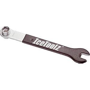

If you fit pedals for the first time, put a little grease on the thread, screw it in by hand, most important, until the pedal is almost completely in. If you feel any resistance, unscrew and check the thread. Then you need a good long handle spanner, something of this size, and screw it in quite tight (about 40NM)
