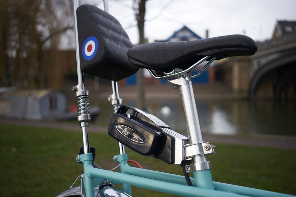

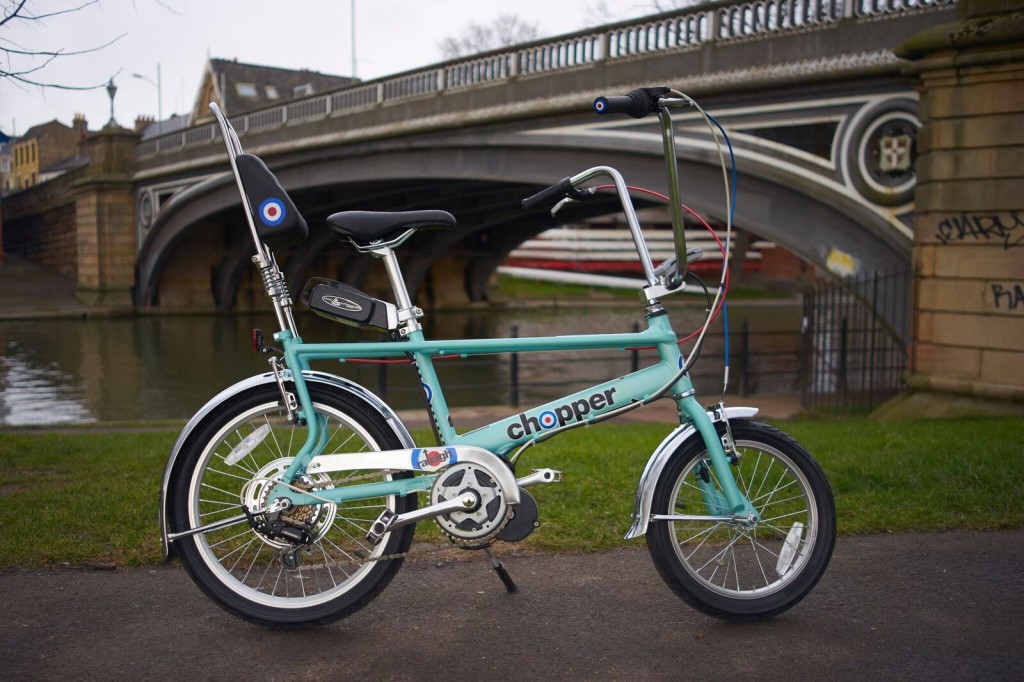

Raleigh told us they were going to reintroduce the Chopper in limited numbers and we thought it would be fun to bring an iconic design fully up to date. We’ve tried to maintain the classic look of the Chopper and use components, including a 250w motor, that fit with the distinctive styling but also suggest something else is going on.
What conversion kit did you use?

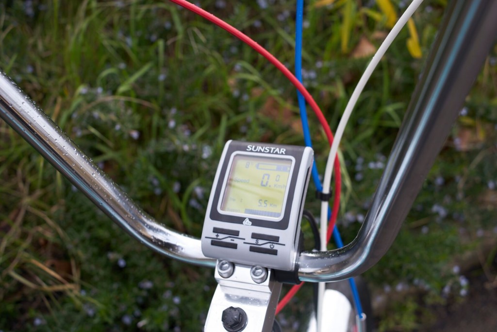

We used the Sunstar iBike S03+ system. It’s a Japanese crank drive that’s been around for a long time (in Japan) and 5 years now in Europe. It works very much like the Bosch or Yamaha crank drive systems, in that it is a torque sensing system that provides proportional assistance as you pedal. We used the 24V version so that we could use the tiny Sony battery.
How easy is it to retro-fit a conversion kit?
The conversion is done by removing the pedals, crank and bottom bracket section of the Chopper (generally speaking, not bits that people notice much) and putting the Sunstar components in their place. It’s pretty straight forward to do and only takes a few minutes, especially on a new bike.
