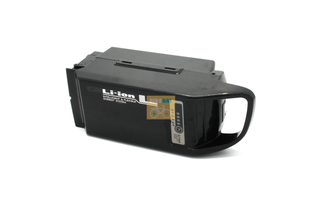

8yr old battery on Gepida bike. Worked OK. Unused for 1yr. Recharged inadvertently left for 1 week in charger. Showing only 1.6V. Charger says charged but still only reached 1.6v. Internal fuse ok.
Any suggestions please?
Any source for cheaper replacement than Gepida quote of €545?

https://bikebat.be/fr/product/yamaha-x60-e0-24v/
tho they might not ship to the uk but if the batt uses can bus comms then you are screwed as you cant recell the packs
Thanks for your advice & the link.
They say can apparently replace cells & electronics but insist on new charger as well - total cost €405 plus post by me.
I think I need to find someone in UK with cells & spot welder.
Sent photos to electric bike world who will replace cells (& electronics?) inc pp for £440 which works out about the same for BikeBat in Netherlands (sound waves suggestion) total cost.
Assuming electronics are OK then replacing cells should be say £30 batteries, £70 new spot welder, £10 metal strips, Labour 3hrs - £100, courier £40 = £250 +£50 Overhead & Profit. Must be able to get it done for <£300??
