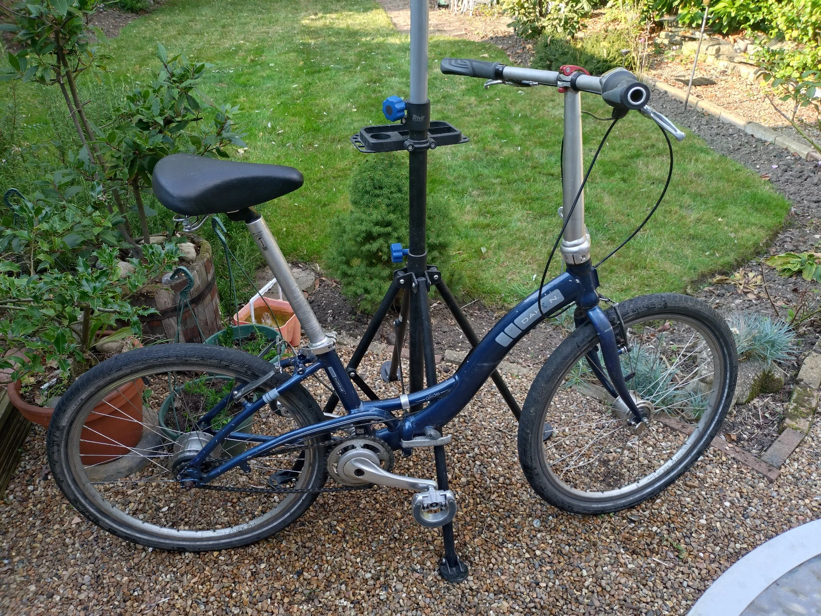

Would a BBS01B fit on this £50 or best offer Dahon Glide? Pinner, London. Has the reinforcement bar over the fold, 24" wheels. Dynamo. Probably won't snap in half.
If a P7:

Yes, it should fit OK, but it's normally the battery that's gone, so you'd have to buy a whole kit, in which case you could fit it to any bike.
A hub-motor Woosh with a defective battery sold for £56 a couple of weeks ago. If I had bought it, I'd have kept the motor, swapped out the controller for a 15A KT one, then replaced the battery with a 48v downtube one. That would beat any crank-drive and be reliable too.
It's unlikely that the motor would be faulty, so that's the last thing I'd change. At 48v, you'd get all the power you'd need for steep hills, and a much smoother ride.
