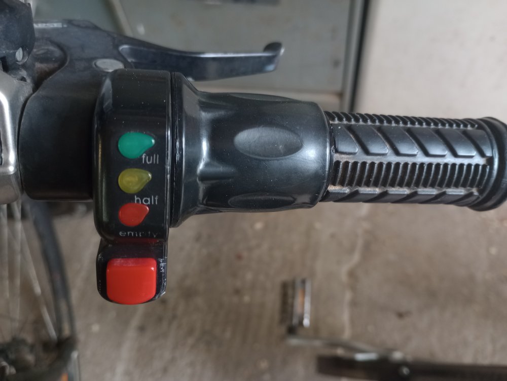

Green and Red on the controller go the throttle, it seems red to red and green to white, with the black on the throttle going to earth, but they've left a query on that black as you'll see on the diagram note. You don't seem to have a wire to connect that black one to, but it must eventually connect to the controller point marked "battery earth".
