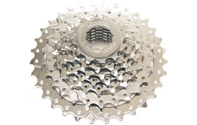

You need to determine whether you have a free-wheel or free-hub rear gear set.
here the free-hub is on the left. you can recognise it by its characteristic retaining collar on top of the smallest cog. Another way is to count the teeth on top gear. A free-hub would normally habe 11 or 12 and a free-wheel 13 or 14, though there can be cross-overs.
his bike is fitted with a 7-speed SRAM PG730 12T-32T.
If he goes for the X08C kit, I can fit a new 7-speed cassette for him for £14.
However, for first conversion, the XF07 front hub + rear rack is the best tried and tested route.
