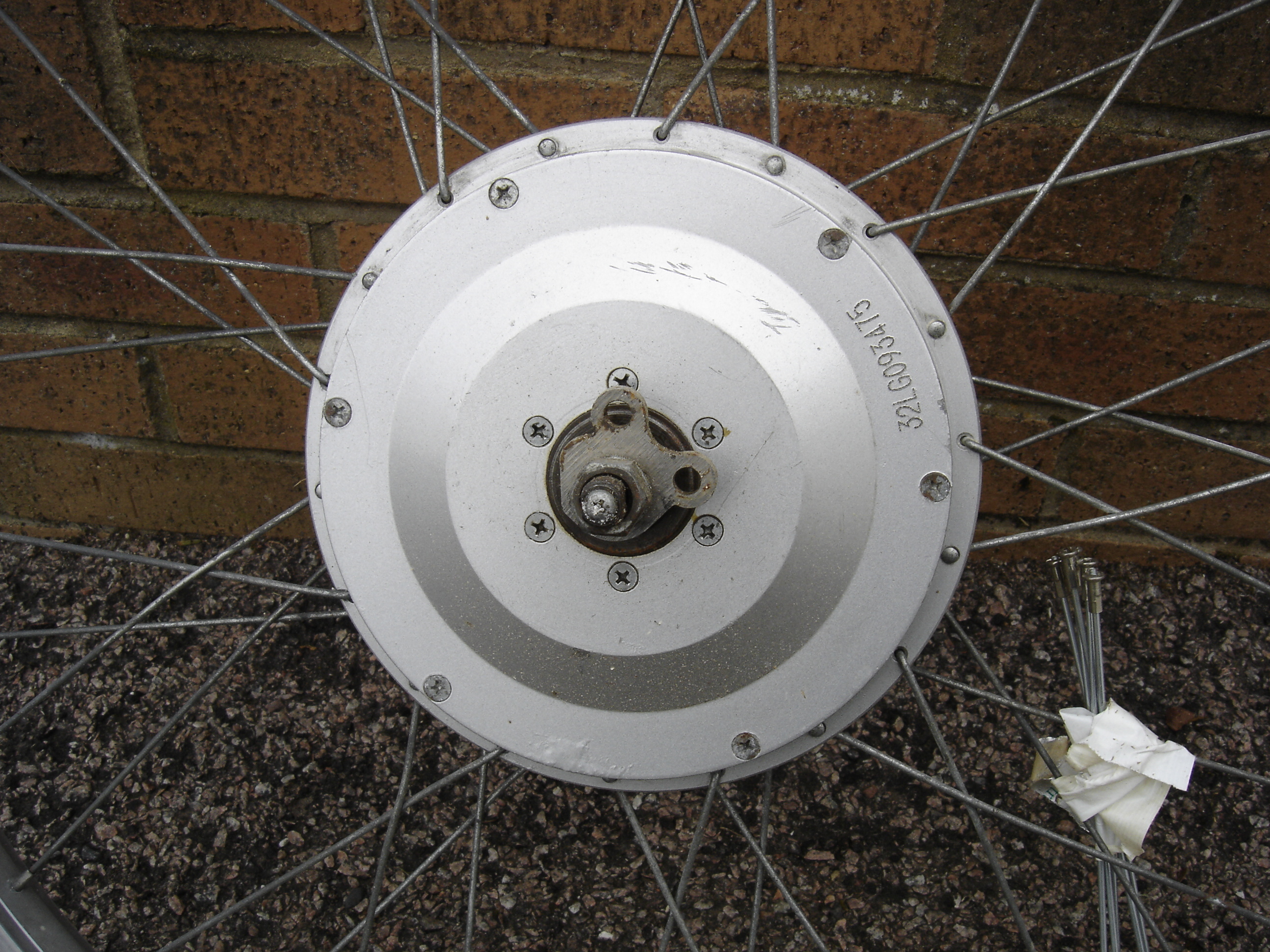

By way of information, Bafang is the manufacturer name of the motor in question. It refers to the Suzhou Bafang company of China.
Their motors are often marked with the name 8 fun and sometimes referred to as that. (Eight is traditionally a lucky number in Chinese culture.)
