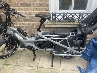

Yesterday on Ebay:
If I wasn't 600+ miles away, I'd have been tempted.
