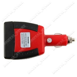

is this what i i need
maplin 12volt modified sinewave 1000watt invertor
this doesn,t use cigarette lighter but is connected directly to the vehicle battery?
Well, after the last new info, I expect one half that size will work. Probably even smaller.
