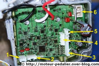

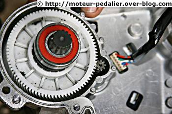

Could the Panasonic motor itself be in need of servicing with new grease, or is it better left alone?

Best left alone Erik, they are not intended to be serviced, there's almost nothing inside that can be and no internal spares are available. The circuit board is fully encapsulated and glued into the r/h crankcase half. I doubt greasing the nylon reduction gear would make any difference.
The software can be reset by a suitably equipped Panasonic e-bike dealer and that might be out of setting. I don't know if you'll have any in Denmark if you are still living there, if not, only getting into Germany will make that possible.
